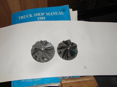

The parts and machine work is about 300.00 If i get your housing and backplate to machine. If we get a slip on housing instead af the Oring surface and a new backplate it is about 50 more.
It isnt a direct bolt on but I have it in my truck and it gives me good low speed boost.
I am not making but a couple bucks on the parts so let me know if you need some stuff.;Sweet
Here is a pic of the wheel size difference
