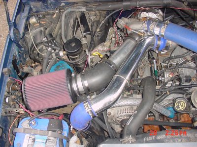

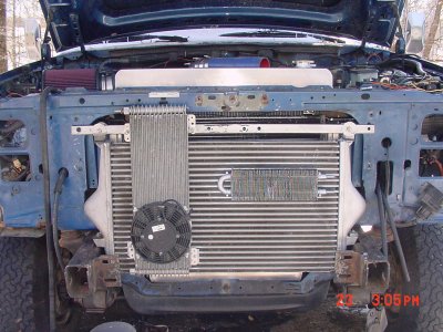

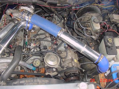

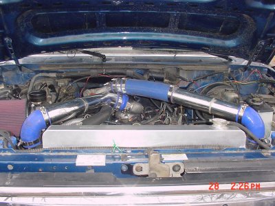

I hooked the dump trailer up today to see how the truck pulled a load, and WOW, this cannot be the same truck! Total loaded weight was 29420 pounds. It's about a 35 mile round trip to the stone quarry with a bunch of sharp turns and small hills. The highest egt was arround 1050 and the boost was 9 psi, I would have pushed it more but it would gain too much speed to make the next turn. Smoke was very minimal unless it was lugging at low rpms then it would really belch it out, but when it downshifted the smoke would clear right up. I am really pleased with how the truck pulles now. Here are a few pictures of the intercooler, air intake, and one of the weight ticket at the scales.

That is awesome, making that kind of power with low boost and EGT's sounds like a great setup.
Nice job on the intercooler install! Did you make your own tubes? are they polished aluminum?
I am going to need to do my own soon,..

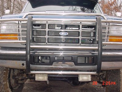

Oh, and my brother wants to know what brand and model guard that is on the front.

That's also one hell of a load. Which model tru-cool are you using. I also really like the fan. So much so I think I'd like to duplicate that setup.
I wish that I could say that I made the tubes, but I didn't. I got pretty lucky and bought them off of ebay. A guy had them made up for an older ats system I think, so I modified them a little and it turned out pretty good, and they are polished but need cleaned up some.

Be patient Sean LOL LOL , I can only do so much at a time, but I will get a short video ASAP. The grille guard is a stainless steel Smittybilt guard, I will try to get the # for you.
The reason that I stopped updating my progress is because I ran out of parts to work with and was just waiting on everything to arrive, and that working on it in 0-15 degree weather wasn't too nice. I figured that that much of a load would tell me what it was capible of. Here is a link to the tru-cool cooler http://www.dieselsite.com/index.asp?PageAction=VIEWPROD&ProdID=205. The fan will most likely never need to be used, the highest temp I have ever seen was 165 and that was backing a trailer up in 98 degree heat. But I had the fan in the basement and barely had enough room to install it so I figured why not.
