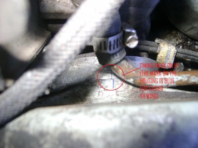

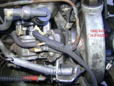

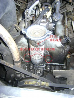

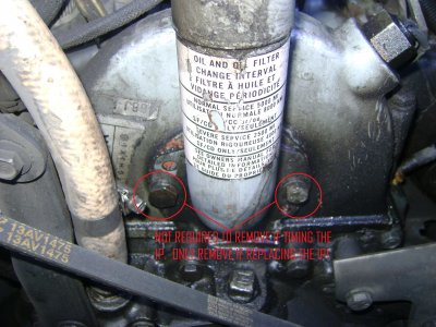

I was hoping someone with a cleaner engine would post pics, but I guess not. LOL I know my engine is dirty, but it runs so I leave it alone. Here are some pics of the IP timing marks. Keep in mind, the bolts in the pics of the oil fill tube only need to be removed if replacing the pump or checking the timing of the IP gear. DO NOT remove the IP housing and/or gear inside (attached to the IP) unless you are fully aware of what you are doing or willing to accept that you could really mess the timing up. The timing marks on the IP are "factory" timing marks and used as a "baseline" adjustment until you can time it with a meter. If the gear inside is off, these marks won't do you much good. There are three 9/16" nuts that hold that IP from turning side to side. You will have to loosen these to change the IP timing. Again, DO NOT attempt this unless you feel you are ready for this and willing to accept the outcome of trying.
