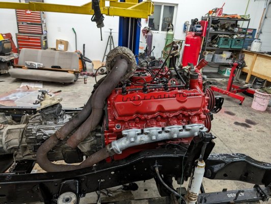

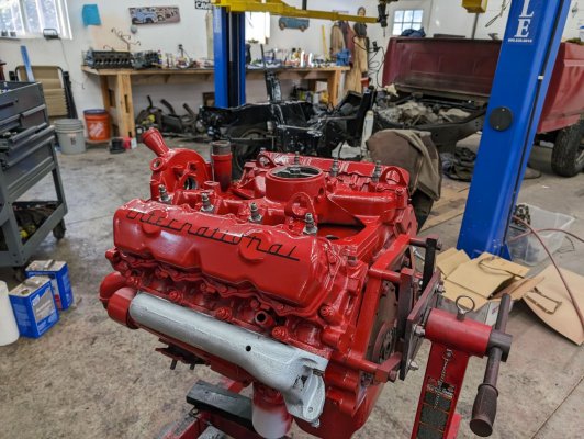

Some history - this is the engine I built up (albeit cheaply - dangit). Pulled the engine (I did have an experienced builder help guide me through it), had heads inspected and valves and seats cleaned up to spec. New Bearings, rings, honed the cylinders, etc.
For those reading attempting to build an engine: don't, DON'T, think your sealing surfaces are *good enough* on your front and rear mains. I've got a driveway stain viewable from space that reminds me daily of my poor decision making skills.
Got it reassembled, and it knocks. Sent in my CDD 110 pump to get it recert'd, and they did. Sent in my injectors (stage 1's) to get recalibrated, and they did.
Still have to check timing, (dang hole is clogged and won't clean out, gotta tear it down to clean in there to time it properly), but the knock seems to chase me, no matter the timing.

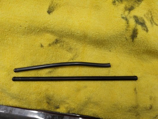

I did, (again - I'm dumb), bend a pushrod when I reassembled the engine the second time to replace leaky rubber valve cover seals with the better cork ones. The bolt on the rocker came loose, pushrod jumped out of the rocker cup, and kapowyee. I haven't gotten to check compression, but the noise was there before and after that uh, "incident.".
