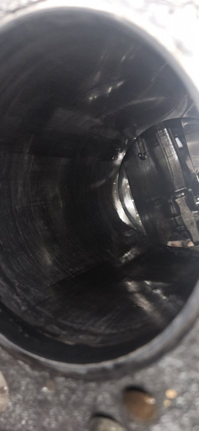

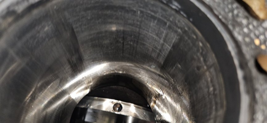

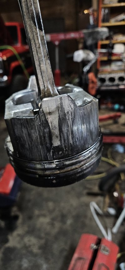

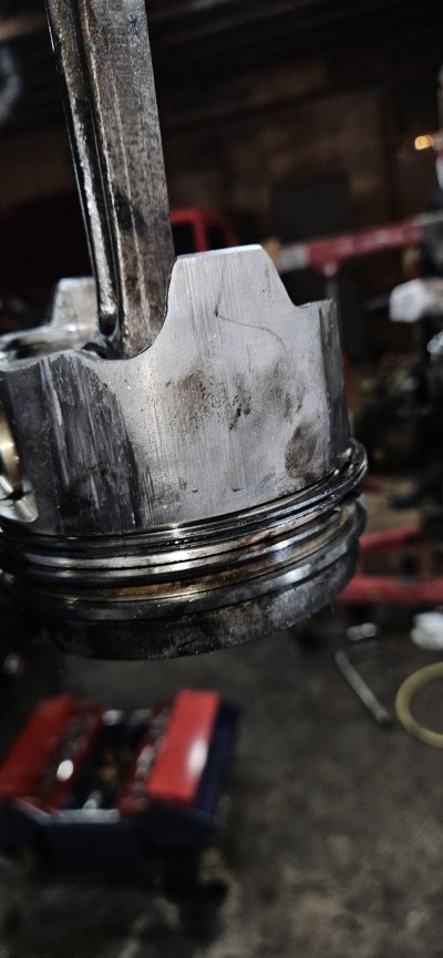

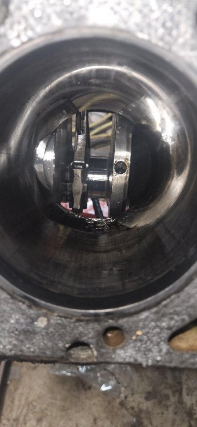

Well I THINK I've found the culprit. Pulled all the pistons, all looked pretty much new except for rear-most passenger cylinder, believe #7 on these engines? Looks to me like it's got a bad case or piston slap. I must have been a little tired the other night, as what I thought was an indent was actually just a fairly shallow groove. The cylinder doesn't seem too bad to me, but the piston is pretty beat up. Does this seem like A: the cause, and B: something I could fix with a new piston and some bigger rings? I'm just not sure if that piston is still slapping, or if that was an old issue that was fixed and the piston just wasn't replaced, since the cylinder wall doesn't seem to reflect nearly as much damage as the piston

A: most likely.
B: probably not. Bigger rings on a standard piston won't fix this issue. In fact, it will make it worse if it even works at all. Depending on the wear in the cylinder, bigger rings may not be able to fit. Even if you were to file the ring grooves down so that they fit in the top of the cylinders, they may not fit toward the bottom of the piston travel. There will be taper in the cylinder meaning that the top of the cylinder will have a larger diameter than the bottom due to the fact that the top of the cylinder wears more than the bottom. The cylinder also won't be perfectly round anymore either. The outside (away from the cam) wears faster than the sides (toward the front and back of the engine) of the cylinder. This is due to the V shape of the engine. Your best bet would be to have all of the cylinders bored to the next oversize and start with all new pistons, rings, and good cylinders.
This may be the time to install a used, running engine and go from there. I know that having to do all of that because of one bad cylinder, but, as they say, one bad apple spoils the bunch. If you have any questions about this, I'd recommend talking to a reputable machine shop that does engine work.

If this were mine I would be doing some very close measuring of all the holes. I would be looking for how much taper and out of round each hole has. You would also need to measure the running clearance between the pistons and there holes. If the block checks out then I would replace the one piston and run it. If you discover the block is out of specs then you will either need to bore to next over size or sleeve it. Other option is a used motor. A good machine shop should be able to help you do that it you do not have the micrometers that you need.
All depends on how you will use the truck and how much you are willing to spend.
