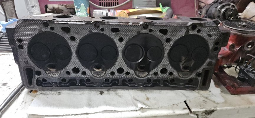

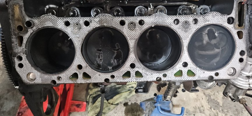

Okay so passenger head is off, nothing really looks out of the ordinary to me except for a really small sort of ridge in the rear passenger cylinder, but it's smooth so not sure what that's about, bad honing job maybe? Gonna pull pistons and valves on that side tomorrow and check those. Anything look out of place to anyone?
