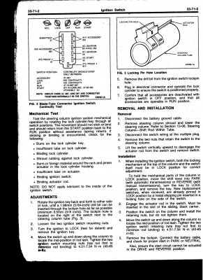

You only have one wire going to the start relay/solenoid, it's gounded internally. The key switch is at the bottom of the steering column, there is a rod from the key switch to the electrical switch, sometimes the little hook at the key breaks off and it won't trigger the switch at the bottom, or the switch can get loose and the rod won't move it. Look there. how to set it, pic below.
