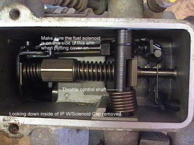

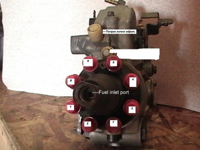

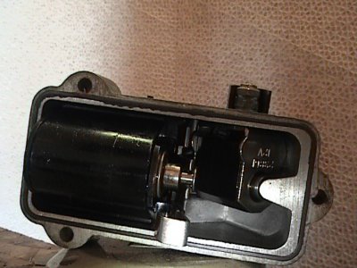

338
IP pump fuel solenoid. Make sure the bright silver square in the middle of the solenoid cap is where I show in the other pic, or a runaway engine can occure. The pump pic shows the correct steel line placement to injectors. Numbers indicate the cyl. numbers.
Look at the cover, there is a black rubber seal around the edge, there are no seals where the screws go thru.
You may or maynot have a torque screw, disregard it.
It's natural for the voltage to drop some with other things operating, voltage is OK as long as it don't drop below 10 VDC. Your chasing your tail with all the voltage readings, there just fine.

338
Old Bull, what do you mean bright silver square? What am I supposed to DO/NOT do, to avoid runaway?
If you look at the cover with the solenoids, you will see a bright silver square at the bottom, that pushes against the black tab where it is clearly noted on the other pic of the IP with cover off. If it's not in that position the fuel will not shut off and you have a runaway engine, turning the key OFF has no effect.
You won't be able to drive it, that engine will speed up so fast you have hardly time to stop the air at the intake. Thats the only way you can stop it shut the air off.
