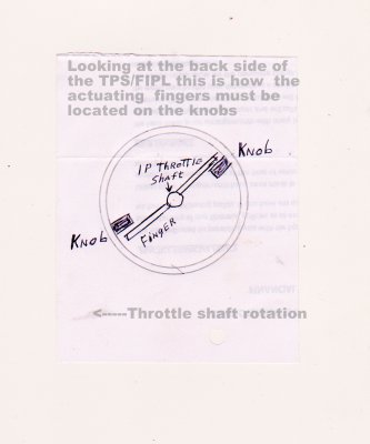

When you changed the FILP, did you make sure the actuating fingers were placed like the pic below.

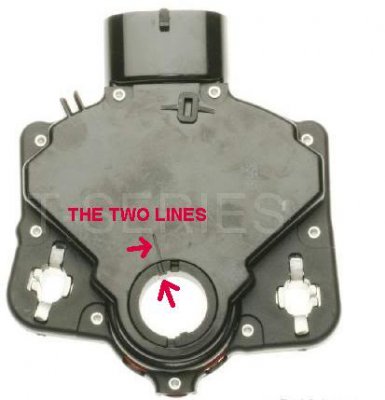

did you remove it and re-install it while shifted in N?
I never changed it, I left the one that was on the pump that I swapped in, I just adjusted it to 1.2V...Funny you should ask that, I was thinking of pulling the TPS off of the old injector pump and swapping it onto the one in the truck now...I never had the OD off light flashing until I swapped injector pumps, but I was having the hard shifts...
Yes, I made sure that it was in neutral when I did it, and the lines were lined up correctly.
