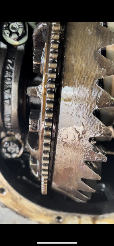

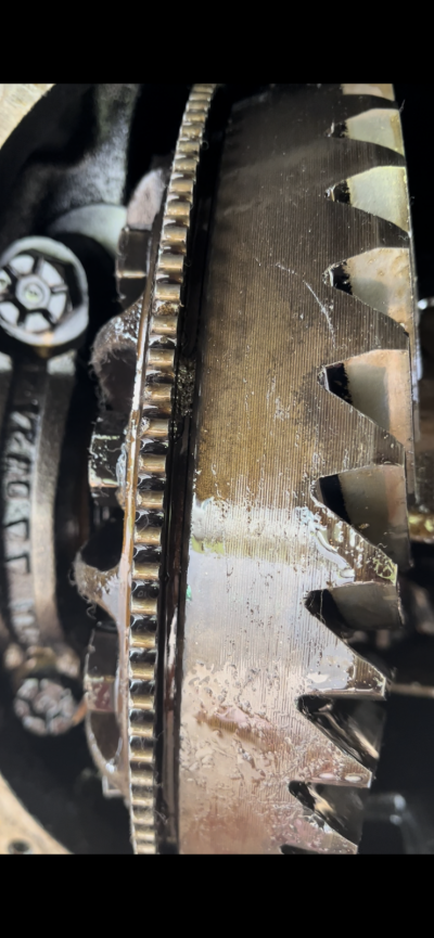

I’m kinda piggybacking off my post about chasing an OD light in my 92 F250. Popped off the differential cover to check out the tone ring, which looks like it has a couple burrs on some teeth. Found metal chunks in the sump. I’m guessing this is what damaged the tone ring. Ring and pinion look good, no obvious gouges or chunks missing. I’ve attached a couple pictures of the chaos. Are these chunks from the limited slip?

More carnage

This is the first I’ve been in it since I bought it a couple years ago. It’s obviously been neglected. What are the chances the pinion bearings look like this? Driver side differential bearing is shot, passenger side looks new.
I still can’t figure out where the metal chunks came from. A theory I have is that previous owner had an issue and repaired it but left this crap in the bottom of the housing.

Maybe its metal shed from the pinion bearing?
I would be changing all the bearings since you're in there. You may need to shim it differently... I blindly did bearing re&re on a dana 70 once, and there was no carrier pre-load with the new bearings and the same shims. The housing had worn.
There’s just too much metal to be from the worn bearings. The bigger piece is there is concave. Someone has suggested it might be a washer from the spider gears or from the LS clutch pack but everything looks intact

I considered it might be a chunk of pinion bearing cage...
I’m able to get a good look at the pinion bearing and it’s intact. I’ll look again this week but I'm leaning towards a retaining clip for the clutch pack slipped out and got mangled. I’ll keep ya posted
