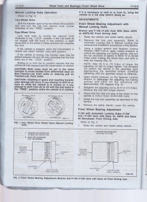

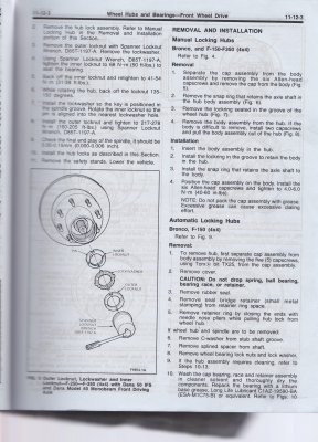

338
Maybe This will help. A 116 post's and 11 days, unbelievable for a lock nut spanner wrench.

Except he has a DANA 44 outer spindle and axle and locknut Bill...not a 50
