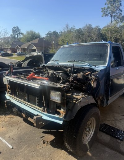

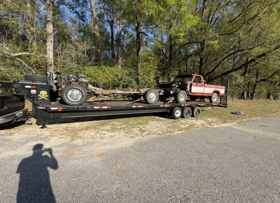

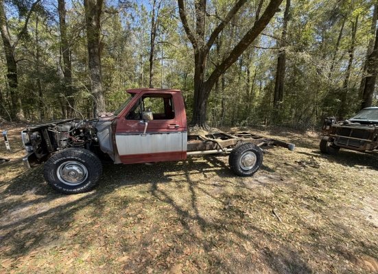

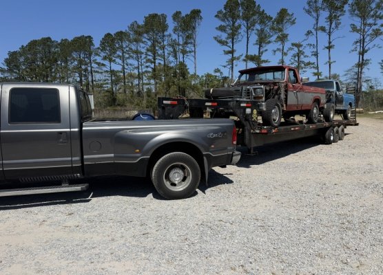

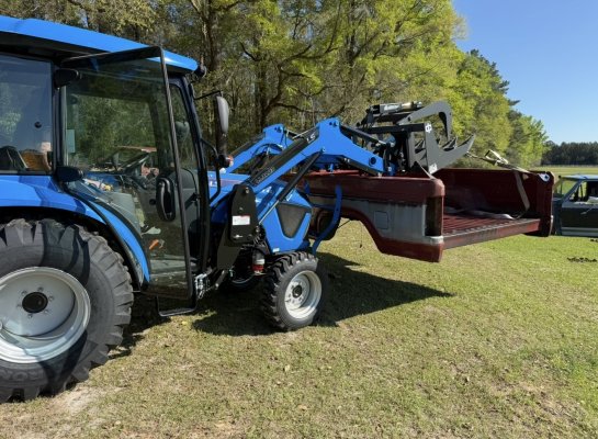

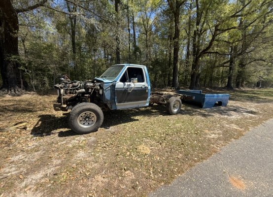

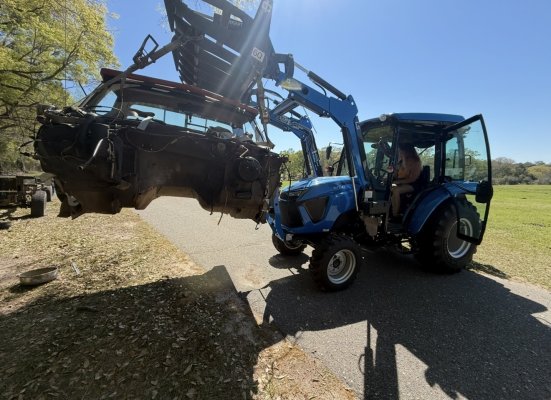

Well it wasn’t today but the last couple of days.
Got the body swap done this past weekend. Tore the front ends apart and broke loose all the body/bed bolts Friday. Saturday I hauled them up to the horse ranch and used the tractor to swap the cabs. Made sure to run the IDI off a single battery and jumper wire to make moving it around a lot easier. Got the body and bed bolted down, all the accessories hooked back up short of the front clip and the wiring.
Sunday was body panels, interior reassembly and the smaller details. The swap went so smooth I drove it to work today. Minor oil leak coming from the fuel pump gasket but that’s an easy fix.
The whole goal behind doing the swap was fuel mileage, believe it or not. I have literally nothing but time invested into doing this and the tired 351W that was getting 7 mpg gets to rest.
Somehow I forgot to get a finished project picture but she’s doing work now.
Man, thats serious......great job!

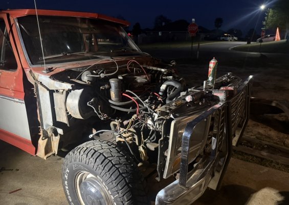

Well kept working through some more old truck woes today. Got to work and found out the truck was spraying fuel from the #3 injector area. Local parts house had an injector return line kit. No dice….
Limped it home and thankfully that core injection pump I got from @Jesus Freak had spare lines on it. Swapped it out and she’s good as new.
Also swapped out front pads, rubber brakes lines, swapped out the leaky master cylinder, and got rid of the clogged 15+ year old muffler in favor of a 3” flow master FX that runs to just in front of the rear axle.
Should be a much better drive to work tomorrow!

I'm considering a 3 1/2" Hypermax which I believe is similar to the Flowmaster. Do you notice any improvement, and is the cab noise worse?
