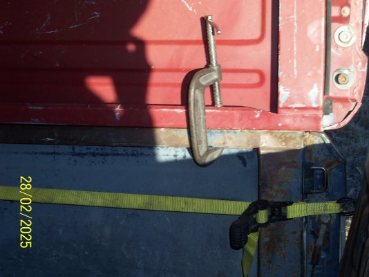

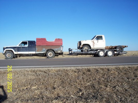

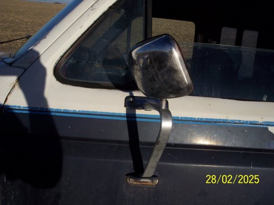

Today was another adventure for me and the Blue Truck. I bought a different bed for the plow truck that I bought a couple of weeks ago. The guy was also selling a 1982 "F350". A guy I work with wanted it so he paid me to bring it back with me. I like getting paid to do truck things with my truck! The trip back wasn't very eventful, thankfully. The only excitement was when I had driven about 12-13 miles back toward home and there was a loud THUNK on the driver's door. I saw something out of the corner of my eye and almost had to scrape out my drawers since the window was down at that point. The mirror bracket was folded back about half way to the door and the mirror itself was pointed at the sky. I stopped and looked at my truck. Nothing was missing so I guess it must have been a bird. There was quite a few flying over the highway at a pretty low height for some reason. The bracket moved back out but the mirror didn't want to move back down. I decided to let it stay there, but that didn't last a mile. I pulled into a small town 7-8 miles farther down the road and loosened one of the screws that hold it tight. Then I moved it back into
place and tightened up the screw again. I stopped along the way to B S with an old friend for 2 1/2 hours or so. I was easily able to hold 65-70 in 5th gear, but I left it in 4th and held the speed to 55-60 after dark just in case of deer. A long 11 1/2 hour trip from leaving town until I got home, but it wasn't too bad other than that.
14,976
14,078
As I was going to sleep last night, I realized that I forgot to add the pictures so here they are. One shows the mirror angle. One shows how the bed was held down. The other is obvious.
