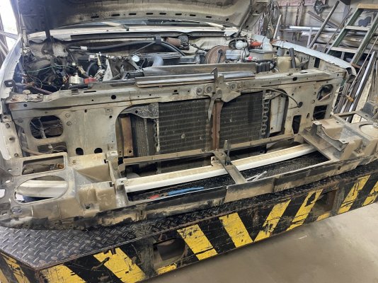

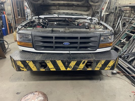

New headlight housings, relays and led bulbs. Found out the housing mount clips aren’t too bad if you just pull the piece they’re mounted to

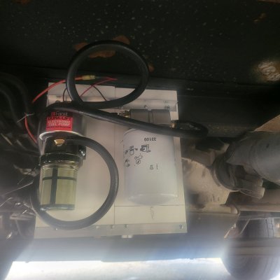

I finally got around to changing the fuel system a bit. Installed a relay off a key activated wire and got it all plumbed up. Only thing left is to pull the fuel line off the original lift pump and put a new piece of line in its place. Would like to remove and cap it off but on the vans it is a ****** to get at. Eventually will remove the factory fuel filter as the location is insane and you need to pull the doghouse and remove the air filter completely to get at it.
