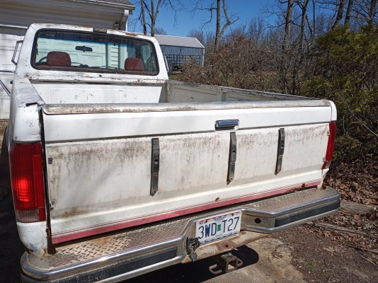

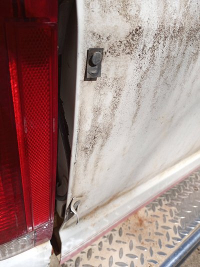

The trim panel on my tailgate fell off today... one end came loose because the flimsy sheet metal clip broke, and then the bumps did the rest.
Looks like I need the clips and the three large plastic mounting pieces too. Any idea where to get them? thanks.

The top halves of the plastic mounting pieces are intact, so I hung the trim panel on them and bolted each end to the tailgate where the metal clips used to live. And a screw in the center into the middle plastic brace. It's not going to come off now and the two bolt heads are barely noticeable. MacGyvered it! ;Sweet
While I was back there, I also removed the many screws holding the access panel, and lubricated the handle mechanism. Some dry Teflon lube for the latches themselves. Now you don't have to practically break the handle off to open the tailgate, and no slamming is needed - just push it closed :)

Dennis carpenter has some obscure stuff like that, buuttttt $$$$$$$$$......

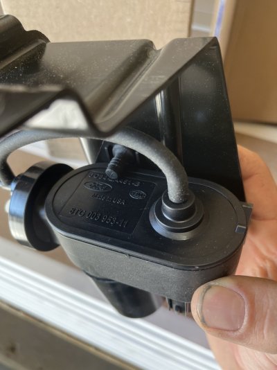

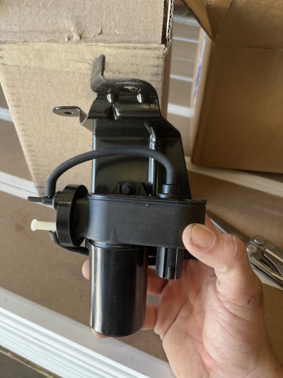

Already have hydro boost, working on electric cruise, deleted the c6 trans so I figured now that napa refused warranty on my vacuum pump it was time for an electric
Man do I love to see made in USA parts
Mounted it where my factory Jack would go
It auto shuts off when done making vacuum
Actuates max ac and my heater core shut off and it’s done I plug a vacuum line and it starts pumping again
I bet I even saved a horse power deleted the mechanical pump LOL
