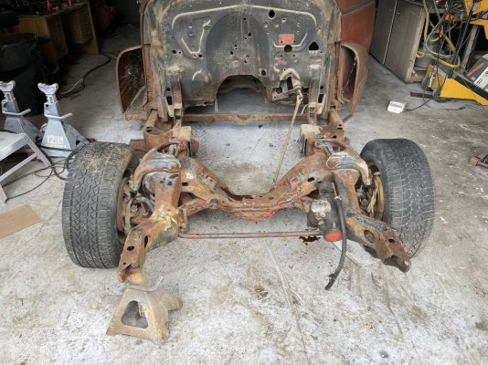

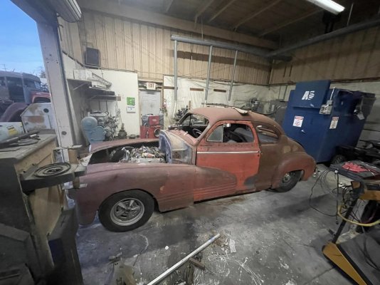

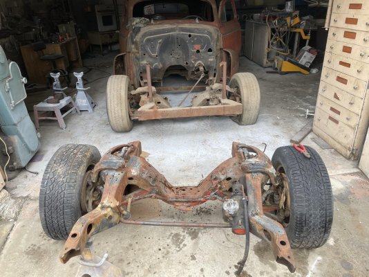

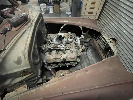

this identifies as a truck :cheers:
been hoarding parts for days for this...
had some extra time, but no cash, so i created my next IDI build.

@IDIoit, I have a front frame bit, and now I have a plan for it. Someday. When I get my other projects finished. Probably never. But still, it's a plan!
