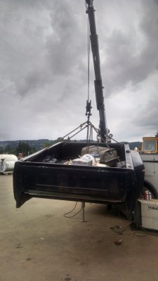

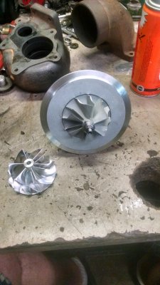

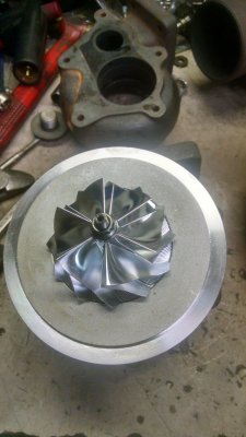

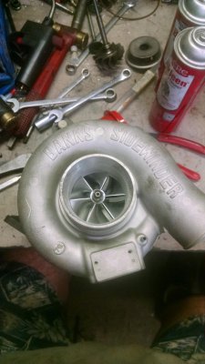

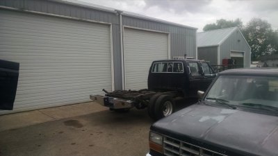

dually fuel system convert.
Putting in a bronco tank, diesel switch valve. Cab mounts,shocks, maybe some frame paint. Three bed bolt we had to break off, never had any rusted like this.pics to follow. So, nice and easy way to remove box, got bronco tank in, sending unit pumps removed, modded to suck tanks dry, took out stupid diaphragm switch pot, installed and wired tank valve, need to mod dash wiring to work the switch valve, easy peasy. Woke up pretty crappy feeling but this afternoon built some turbos, took pics of done ones, banks mitsu with a billet wheel that I had made, since no one makes a replacement, its 2.5 mm bigger on inducer, IDI10T's wicked wheel II install, housing requires clearancing , all the comp housings I have, 8, are exactly the same. Got one shipped and now am gathering stuff to take to SJ this weekend.
