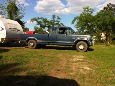

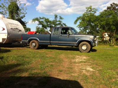

Moving the Camper so we could do some tree work.
Not bad for autozone shocks. LOL

conventional shocks dont do anything for ride height when loaded, they only work under suspension travel.
unless you have air shocks.

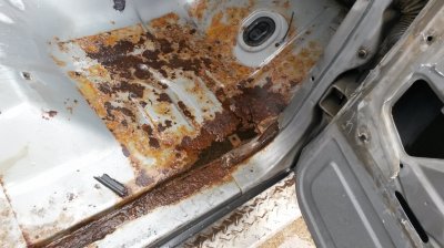

Started out replacing floor boards

Matt33, if you are buying replacement floor pans, check out my build thread in my sig for info you might need about fixing any of that and making it all fit. :rolleyes:
