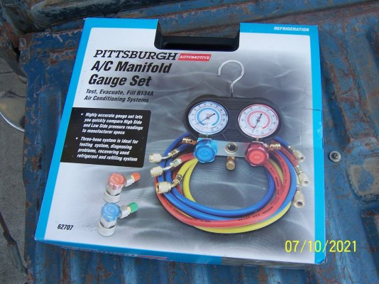

I decided that it was time to buy my own A/C gauges and vacuum pump. Since I'm driving the truck that needs A/C work, I decided that yesterday's 104* didn't sound as nice as the 80's that we had today. I was going to get up early and drive to Harbor Freight (about two miles south of the closest Wal-Mart). Since I just HAD to stay up and wait for my phone to quit charging last night, and that was after midnight, the early morning turned into this afternoon. I got there and they had the gauge set on hand, but they didn't have the vacuum pump for $90. They did have the bigger one for (about) $145 (I wonder why that was?). I was assured that they would have another one on the shelf on Friday, but I decided that the $7 to have it shipped to me was WAY less than I would spend driving the about 145 miles to buy it in person. I ordered it online right after I got home. Then, to be sure that I had everything that I needed to do the new parts install/r134 conversion, I stopped by O'Reilly. The know-nothing, computer keyboard puncher behind the counter had no idea what I wanted when I asked for a r134 conversion kit. They only sell the parts individually so I don't recommend O'Reilly for your conversions! I bought an o-ring set, the conversion service ports, a bottle of PAG46 oil, and a bottle of UV dye. I also grabbed a UV dye detector kit since I was right there. After that, I picked up another overhead shop light to put up in my garage while I was in Wal-Mart. Only little things, but they do add up to big benefits. On the way home, I came up behind a pretty new looking Dodge Crew cab dually. His license plate read "IMAFROG". I guess his first or last name must have been Kermit? He was driving about 5 MPH slower thanI was so it didn't take me long to show him my "IDIPWRD" plate!
