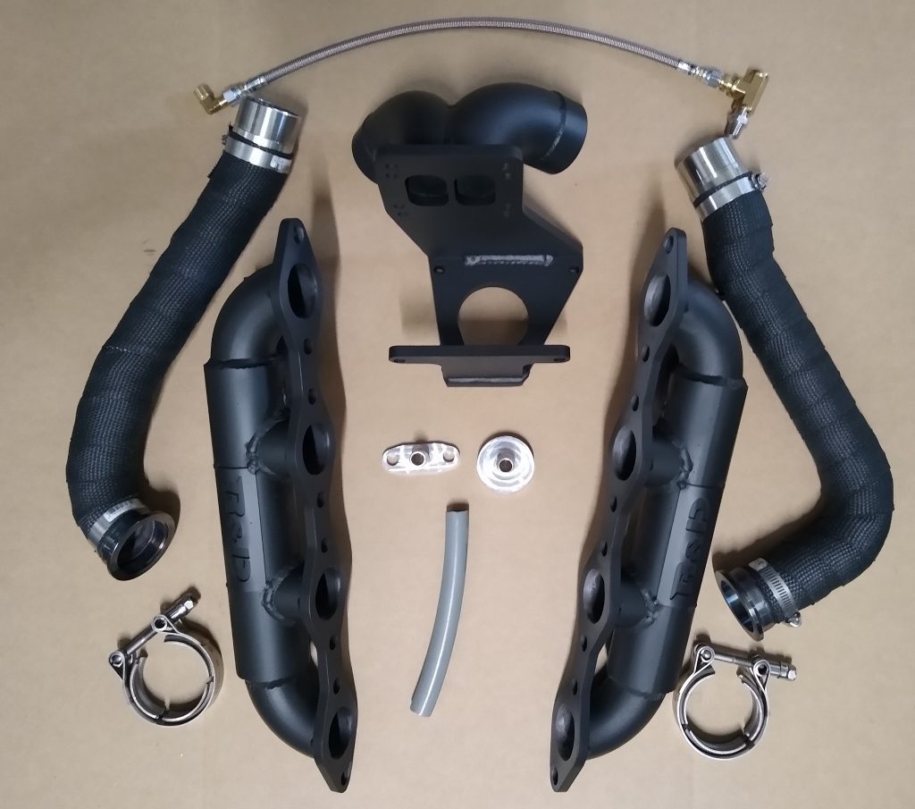

I think 12cm is smallest i would go for dual turbo's because the amount of exhaust that flows out above 1800rpm is going to cause crazy back pressure / turbine drive poressures and high EGT's even 12cm according to the math is a bit small and puts thihings out to lunch above 2200rpm diesel turbine housing sizing and turbo sizing is much different than gasser turbo sizing figure hp to turbo size and nearly double it a 400hp gasser turbo will only do around 200hp or so on a diesel and well then you got to factor in the amount of exhaust CFM is way more than that of a gasser.
anytime you hear instant spool on a turbo on a diesel it usually means high back pressure and specifically high back pressure is bad on our motors as it causes EGT's to go crazy I target a spool up RPM around 1200-1400 rpm's to be best all around that is street driveable anything that spools under this is a low speed low rpm power house that chokes the motor second you get revved up aka get driving down road and then you deal with high EGT's and literally struggle to run interstate speeds and such without riding the line on EGT's and having to literally baby sit the pyrometer 24/7 making for issues if try to pass anyone or climb a hill or anything due to massive spikes in EGT's with slightest attempt to give it more fuel / power.
The t04E is pretty well the stock turbo these motors came with and is not very good at getting much more power than stock and nowhere near your goals so going for turbos with similar turbine housing sizes for spool up is insanity given amount of fuel your are going to have to feed into this setup to get to your goals dual HX35's with 10cm housings is like asking your motor to commit suicide if you get my meaning.
I think a single turbo is best option and if you go with something like R&D idi's setup is simple to maintain and well designed.

I went with the forth the hx35 since had one. Was thinking that even tho the 10cm housing would match the t04e in area for the turbine, the slight larger turbine wheel of the hx35 would slow the spool some. Would keep that in mind and could still switch them for the 12cm ones if is a issue, that is if see boost well below 1200 rpm.
R&D Hotside Turbocharger Kit (Formerly Stage 1) | R&D IDI PERFORMANCE
Back By Popular Demand.
idiperformance.com
That did cross my mine but I think he is in middle of a move, so not sure on restock.
I have got a fair ways in getting manifolds made
The issue with the 10cm vs 12cm is in the radius where it enters the turbine is to small to flow the exhaust at the higher RPMs and reason the factory turbos struggle with high back pressure / turbine drive pressure this is where high EGT's occur not because of lack of fuel / air on intake side but the fight to get exhaust out of the motor and your motor will be inhaling hot exhaust back into motor and unable to get exhaust out as for transmission I understand your like of the 4 speed its a good trans the issue is not really that the trans is a bad choice its the amount of load your wanting to force the motor to fight against all the time in short 3.55 gears and 35 inch tires is alot of load its doable and has been done alot. I just find your RPM's will climb so slow that your going to make your engine fight itself I think 3.73 gears myself is a better ratio but then you sacrifice your highway gearing. I like the ZF5 for the bigblock gassers to be best just need to drill them to fit our motors and to be honest ZF5 transmissions are not to bad again we are talking diesel motor not gasser you need to remember shifting it like you do your gasser will kill your diesel doing it like you do your gasser turned up as far as your want will scatter your motor across a highway somewhere in seconds.
