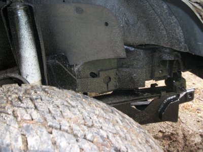

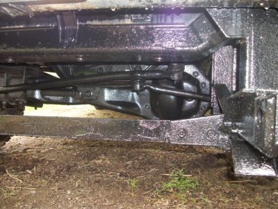

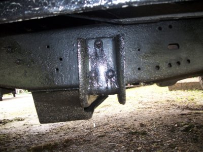

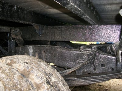

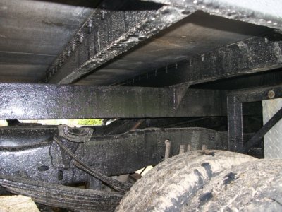

por-15 user here.nothing lasts forever though fyi.
