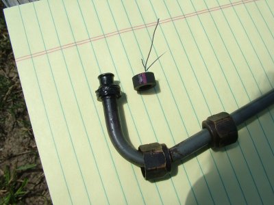

I am familiar with these engines, but what part are you calling the olives?
The viton o-rings that Russ sells are far supirour to what comes in any kit out there. As for the olives.. Those are in the lines to and from the fuel filter. The line from the lift pump to the filter head has one 3/8 inch tubing olive in it. The line from the filter to the injection pump has two olives in it and they are 5/16 tubing. One in each end. And finally the return line brass fitting way back at number 7 cylinder intake manifold passage has a 3/8 olive in it. Most members have no idea that olive igsists.... Sometimes these olives are tuffer than daddys shoes to get out of the brass nuts. A dental pick works very well. Soaking them in brake fluid will soften them overnite too..

... but what part are you calling the olives?
That's a good explanation, Gary. It seems to have done the trick. However, I have a visual to add.
This picture shows an olive, plus part of the hard line between the fuel filter and the IP. Remember, there are two olives on that line, one at either end. The arrow points to a new olive, not yet installed. You can also see an old olive still on the hard line. That one is pretty well worn.
