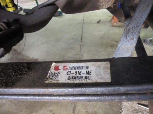

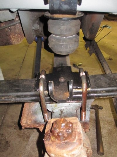

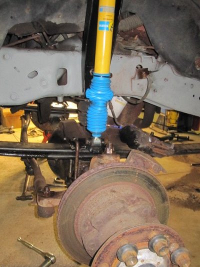

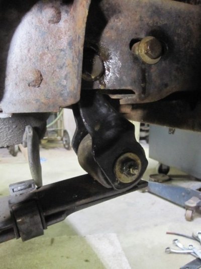

Just put new stock leaf's, track bar bushings and yellow Bilstein's on this D60, grease zerk in rear spring bolt, had to cut OG bolts out to replace, never again!

Had to cut bolt's on front spring rear mount, pics are of a leaf spring front end with Dana 60 axle, shocks bolt right up, not rear. Try tire rack also for Bilsteins, they have good prices on them last I knew.
This is the proper way, Bilstein use the labels for orientation, Bilsteins for my VW have the stem on the top, it varies with application, boots on these have drain holes at bottom, otherwise shock doesn't know which way is up! as long as it has same mounts at each end.
Noticed my shackle photo was the front, put grease zerks in those also!
