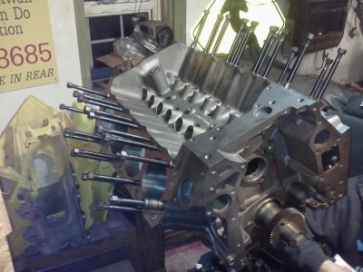

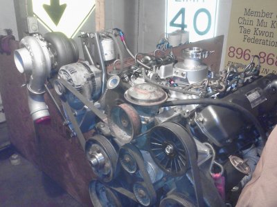

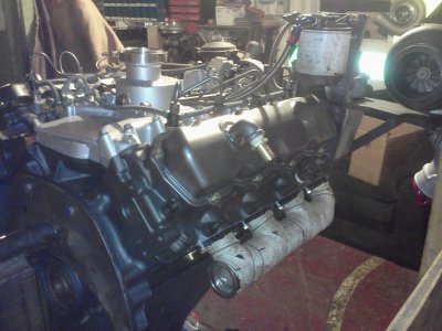

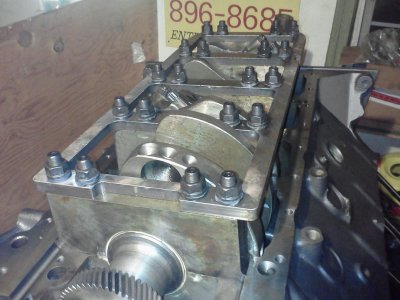

Well guys here is some of the build info and pics. I'll keep adding pics and info until completed.
1983 F-250 4" lift on 35's
6.9L Bored .30 over
Cryoed and heat treated Rods
Arp head studs
Custom Bottom end girdle with ARP studs
Professionally Ported and Polished Heads
Mahle Pistons with .100 shaved off the top and Ceramic Coated
Compression lower to approx. 16.5:1
Injection pump maxed out by Ken at DPS. (says pump will deliver 4x stock pump)
Injectors maxed out to match Pump
Custom Built Log style Manifolds
Custom Mounted Holset HX-50 66mm inducer 19cm exhaust housing
Converted to Serpentine belt system
Twin Holly Black Fuel Pumps
Superduty Axles D50 front and Sterling 10.25 Rear
OBS Radiator
Superduty Intercooler
Anyway check it out over there. It looks like a pretty promising build. He said it should be done by the first if the year too.
88 Ford
Dec 22, 2008
1,784
6
San Diego, CA
Here are his pics...

That's a lot of coin to be dropping on a "screwing around" truck......Regular FelPro HGs.....I wonder if he coated them.
88 Ford
Dec 22, 2008
1,784
6
San Diego, CA
I don't think it is anymore than NMB2 dropped into his engine. Just pretty much the machine work and the parts which isn't too terrible and plus is makes for a fun DD when its up and running. Also as far as the gaskets I wouldn't coat them if I were him IMO. It is debateable whether it helps or hurts the gaskets holding strength.

Stock cam:eek: Thats the first thing I thought about when I looked at getting more power. He says there runing it for now. But I think he will be pulling it down for a better grind after they see it run.:puke: I dont think that stock cam will let the engine move enuff air for all that fuel.cookoo Don't get me wrong I love the build :love: I just would have used a better cam the first time around.:D
88 Ford
Dec 22, 2008
1,784
6
San Diego, CA
It would have been cool to see what he did with a better cam but now I guess we will see what a good build does with a stock cam. I do hope he dynos it though.

I also wonder what the length of the studs are with that girdle too?
Hmm not sure. I wonder if they help keep the blocks from twisting or if it is just for even support across the crank bearings. Either way its a pretty serious modification ;Sweet
88 Ford
Dec 22, 2008
1,784
6
San Diego, CA
Either way its a good modification and he said they only had to modify the pan slightly.
