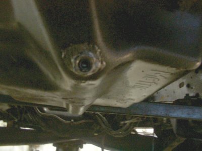

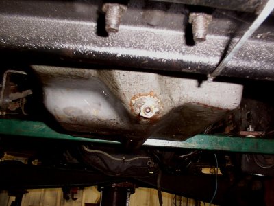

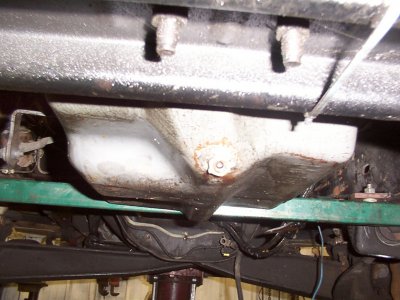

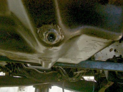

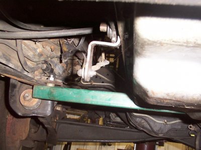

Here are som pics of my transmission support I made.It allows me to move the truck or whatever I need to do while the engine is out.I used a block of wood to adjust the height to the same height as it is while the engine is in.
Another note -after several engine changes I came to the conclusion the if I take the motor mounts off the block,and off the frame(completly out of the truck) it would be easier-It was!!! I thought it would be hard to remove the mounts.but by lifting the engine a little after I unbolted the mounts from the front crosmember they slid out very easy.Finding the right combination of wrenches was a little challanging -but was easy to bolt in after I found the right wrench combo. It made lining up the bell housing a snap.After about 6 engine changes on these type trucks I would never do it again with out completly removing the mounts.
