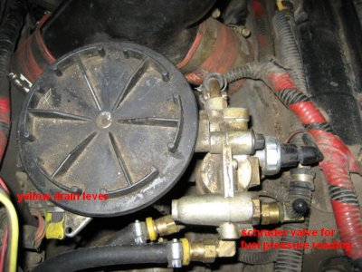

Here's my (very dirty) OBS PSD fuel bowl and fuel pressure regulator. My schrader valve has brass pieces added to give me a 90* bend.

Would you mount in it the same position as on the PS? Cause I'm thinking that you couldnt do it cause the intake manifold would be in the way of mounting it in the valley. But maybe I'm wrong :dunno

not sure where you would mount it.
cost is a also a factor.
one from a SD would be easier as the bolts are in from the front.
on the OBS it bolts down through into the valley.
not sure if pressure has any bearing on the filters as the OBS is only 4-7 psi, but the SD is 50 +
