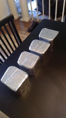

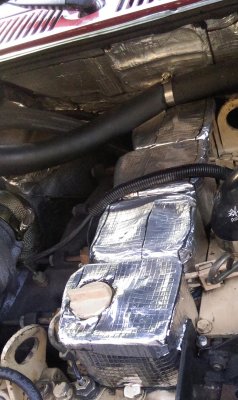

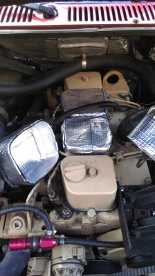

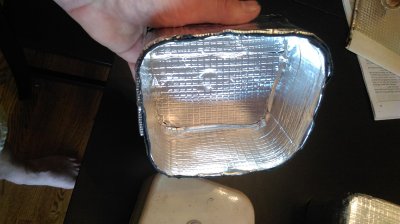

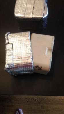

I made some valve cover noise reduction hats. I had a bunch of sound deadener material left over from my build so I had this idea. Basically there are 2 layers of sound deadener, sticky side to sticky side. I used a spare valve cover to make the shape. Then they just slid over the valve covers.
Jury is still out, but they seemed to cancel out a lot of the noise. I figured I have nothing to lose, easy enough to slide back off if I dont like them. So far I like them besides being ugly as sin LOL. I'm going to use more of my material to cover the oil pan and see what that does, but for that I'll just stick 2 layers on.

I'm sure that works better.
I've heard of people layering on bed liner to do the same thing.
