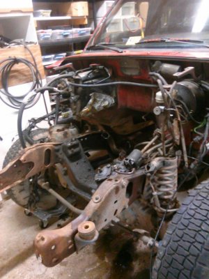

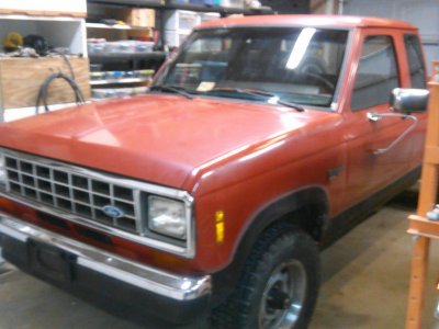

here it is when i got it home two weeks ago.
Its getting a 4bt

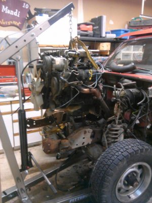

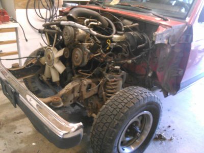

old nasty gasser engine up

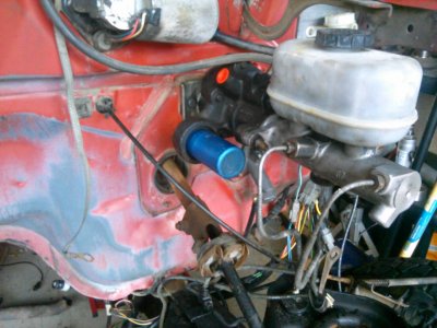

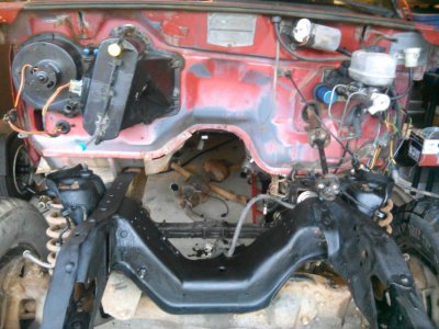

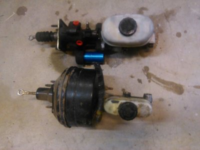

new a/c evaporator installed, new heater core, new blower motor and resistor pack. Started cleaning up the frame rails, Plus got a dang good start on the hydroboost conversion.;Sweet

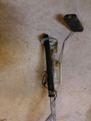

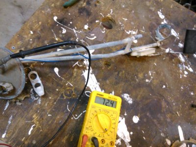

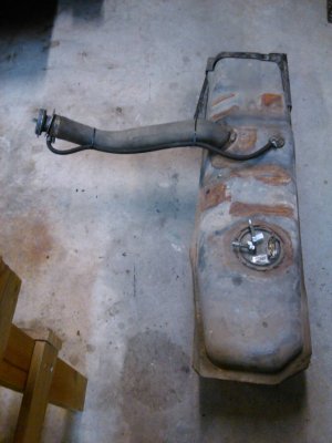

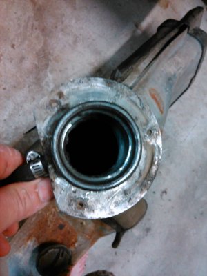

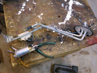

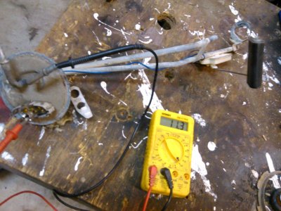

Been working on converting the stock fuel system.
Got both gasser fuel pumps removed, as well as the fuel pressure regulator, and filter.
Also tore out all the stock fuel line. I have 30ft of stainless on order to replace it.
Tested out the sending unit, it seems ok, so it will say. I just extended the pipe down for a pickup were the pump was.
Got the fuel filler mod done, and knocked out the gas sized nozzle restricter.
did some more painting on the frame rails. Man its a lot of work making a truck! :rotflmao

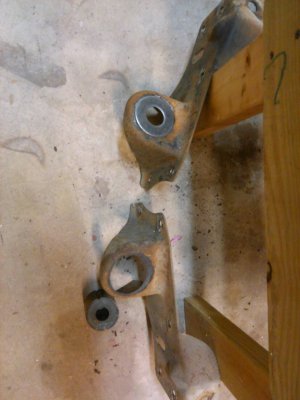

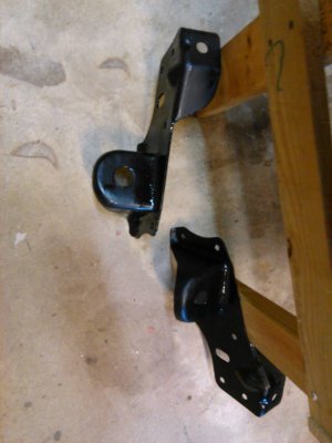

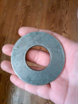

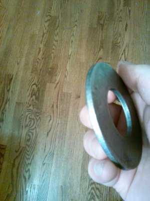

body mounts suck
started adding the 3" body lift last week. I'd prefer to not have any body lift, but I need all the room I can get in the trans tunnel.

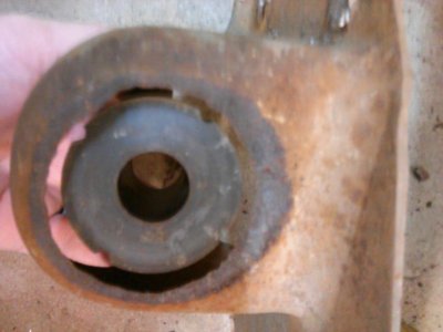

In doing so I discovered the rear cab mount brackets to be rotted through. You can see in the pic where the new bushing is waaaaay smaller than the new custom rust hole...
So I had to cut the rivets off to remove the brackets. Looks like the the 3/16th" thick washers I found will work well. Now I just need to cut away the bad metal and weld them in.

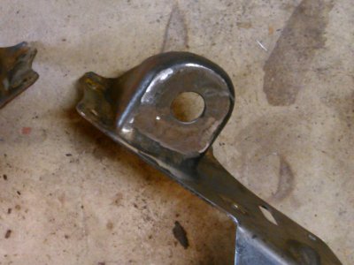

got the bad metal cut out, the brackets cleaned up, and the washers welded in.
Fresh coat of paint, good for another 30 years! :Thumbs Up
