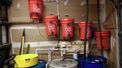

My "processor" is primarily a settling system, and a 2 micron final filter when delivered to the truck tank.
On the bad batch, let's just say I rushed things a bit LOL.
Normally, the oil sits in the cubes undisturbed for 2 weeks. Then I set a cube into the yellow funnel on the left blue barrel, and cut a hole in it maybe a half inch from the bottom. This keeps the "ewwww" in the cube, and the better oil drains into the barrel.
From there I pump the bucket on the far left full, and it slowly trickles and flows clean settled oil off the top of each bucket into one of my two finishing barrels.
Then it gets pumped into the truck going through a 2 micron filter on the way.

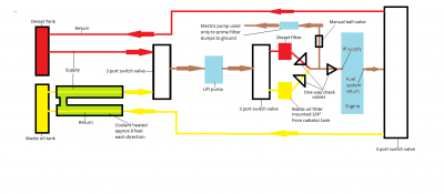

Got these bad boys mounted this weekend. Now I have a huge dedicated diesel filter, and a huge dedicated waste oil filter. I drew out all the components so I can come to this post a year from now and figure out what I did. LOL
Really happy with how everything came out.

Looks good, how fast is the purge time?
F350camper
BOOST!
Jan 11, 2005
1,950
671
USA
Not horrible, about a minute and a half for each one. They hold a little less than 1/2 a gallon each. Beats pumping the prime lever :D
