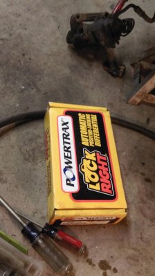

So how do you like the powertrax?

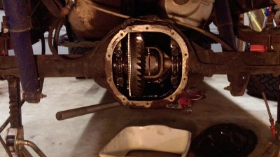

The locker has been awesome. Its crude and clunky sometimes on dry pavement and sharp quick turns, but it locks up solid for much needed traction in mud and snow. In 4x4 low i feel unstoppable! Hahah, makes me want to tuck one into the front diff! But I dont know if I will, that will just put more stress on my already less than stout dana 35 up there.
I originally bought a Powertrax for the rear diff. in my 1997 Ranger. Then I got a deal on an Eaton E-Locker and put that in instead. I know what you mean when you say you feel unstoppable! Got in and out of some tough spots with that Ranger using the E-Locker.

Unless you are planning on off-roading the ranger a lot I would advise against locking the front. It can make a 4x4 ill mannered on slick roads unless you go with a selectable locker that you just use for sticky situations. Even the guys I used to mud race with would not lock the front diff because it caused control problems. Just something to think about.
