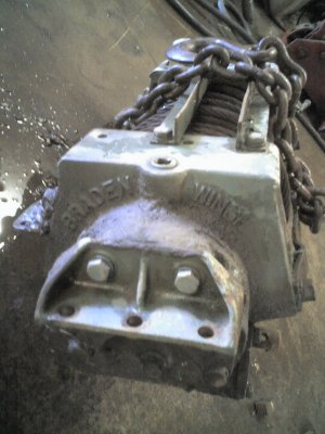

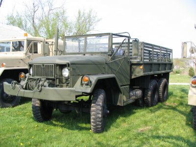

Ok I have been viewing this here winch for a while now. The guy is asking 300 bucks, and it's kinda about the size I think I should have considering all I plan to do...(Long term Plan that is)
That being said, It appears to be a M35A2 cargo winch and I would like to know capacity. The owner doesn't have a clue what it's single line pull is and so forth. The guy says it has 9/16" cable:eek: :love:
All I have found thus far stated that it's got 200' of cable and rated at 10,000 lbs pull....seems kinda weak for a duece n a half to me.
I have thought of a rear mount hydraulic drive winch such as this.
Any help regarding the single line pull rating would be great.
BTW it is a Braden Winch

Uh works great if you got the MODEL I do not....I did find out from Braden finally that it's rated at 7500 lbs pull.

Uh NOPE not overkill till I have 15-20K single line pull then snatch that to 30-40K pull gotta realize that if I put on 46" tall tires...mud will suck me down hard core....thus need to be able to self recover cause I wont afford those $500+ dollar recovery from BFwrecker!
This is what Braden said
The winch you have is a Model LU-4, which was used on the WW2 military
vehicles built by Dodge, and on into the Korean conflict of the late
50's thru early 60's.
The winch was rated by the US military at 7500 lbs first layer line
pull.
The cable drum is 4.50" barrel diameter x 10.00" flange diam x 12.00"
long between the flanges. I would expect typical rope diameters to be
between 3/8" and 1/2" diameter. The maximum cable storage capacity for
each size is as follows:
3/8" 373'
7/16" 273'
1/2" 195'

If it's good enough to pull a duce & a half shouldn't it work good enough to pull a Bronco or an IDI?
Consider the original owner of said duce & a half ...generally not above leaving the damn thing if it's stuck that bad or usually some nice tank or other chunk of equipment not too far off suitable for recovery.
Also got to remember that if the military rated it for only 7500 , it's built to handle at least twice that. They always rate their equipment WAY lower than what it is actually built for because they know it's going to get severely overloaded in the field. One of the brighter habits they've picked up over the years.
