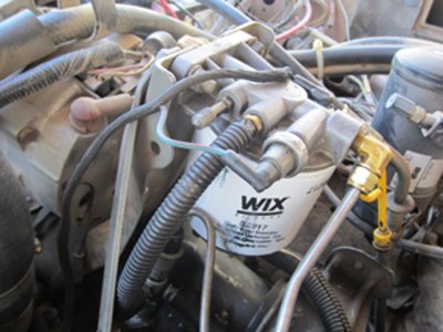

Do yourself a favor and get a remote starter button. When you have trouble starting, you can start it from the outside and see whats going on, and bleed air from the filter while trying to start. There is a schrader valve on the filter to do that, the one with the valve cap on it, pic below. Hook the button up to the start relay on the fender, one clip on the large post, pull the 90* connector off on the side of the start relay, hook the other button clip on there. If you need to stop it, just pull the wire off the IP fuel solenoid (FSS).

Valve cap? Mine's never had one. Well, off to the Ford Stealer to order one of those....... :D
We now return you to your regularly scheduled threading.
Ya don't need one, just keeps the dirt out, same as a tire valve cap. Auto stores have them in a 4 pack, fancy Chrome or just plain plastic.
