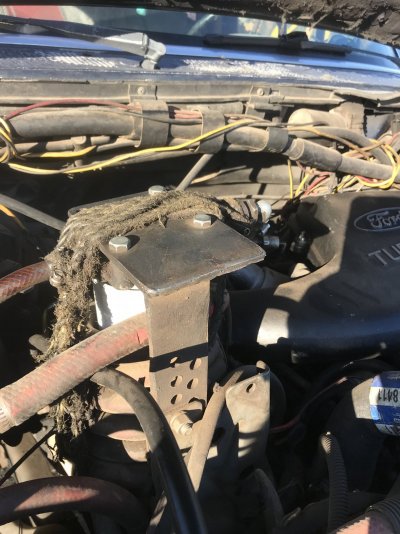

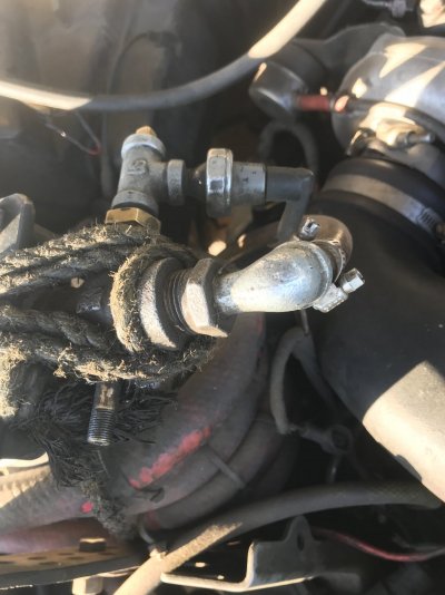

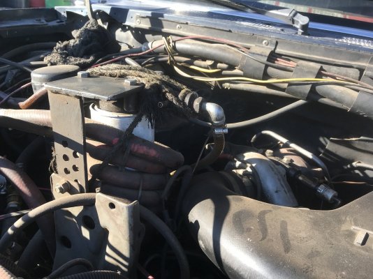

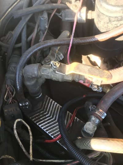

I also have my filter lite sensor & the Schrader valve still there also.
where do they mount? I don't see any provisions on it for those
I just added more small fittings & plumed them in.
Btw Amazon had these filter heads down to about $15 “used “ other nite, now back $22-25.
Trying to get pics posted.
I got 4” body lift so had more room, made taller bracket to mt filter head & taller filters on.
Used pipe bushings in filter head to reduces down and “tees” to add filter lite sender and Schrader valve to bleed & IP feed. About 1/2 way to IP I cut hard line feeding IP, run clear braded line to the hard line from filter head.
I bring my fuel up to 30 plate heat exchanger, thru it & on to fuel filter, then on to IP.
I use 5/8 heater hose from 7.3 head to plate exchanger, then tall filter (currently FF1212) &wrap hose round and round filter to help heat it, then on down and back etc to fuel tanks and heaters.
Been playing and running WVO and WMO mix since’03

Thanks for the pics and explanation. makes sense now. What about the return line?
On mine, '90 with '94 factory IDIT, on my fuel return line from filter, may not be correct but works, I have it plugged off. Down on front pass side injector the fuel return "Tee" that would go to fuel filter I have it with short hose, then plugged.
All pass side fuel return is all together, then crosses over at back of engine to all fuel return on Driver side. Return fuel from top of IP to front Driver side injector return TEE.
On my filter head I used pipe bushings to reduce down & Tee's & street 90's for all my fittings into & from the filter head.
(That dirty greasy piece of rope in my pics only holds that heater hose up around the fuel filter for now LOL When I get rich maybe I'll buy new yellow rope!! LOL )
That's a good idea about wrapping the hose, it unnecessary here in NW Florida. But a good cheap way to get er dun.
Well if 'ya running some of the oil mixes, WVO or WMO, can't get too much heat nearly. I run mixes in rear 38 gal Bronco tank, diesel in front tank & bed tank but have heaters in each tank as well as 2 heaters in my 135 gal bed tank. Also have heater hose run everywhere & insulation all along all fuel lines & return fuel lines & all 3 tanks insulated.
LOL HEAT & MORE HEAT in my world!~! LOL
