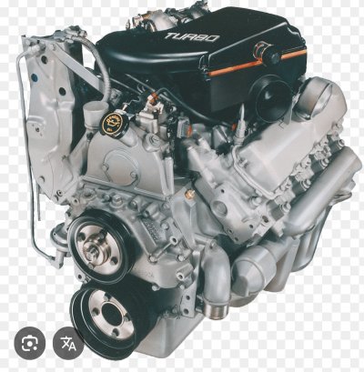

I tried posting pics but site said the files were too large, don’t know how to change them. It’s the factory stock turbo. Exactly same as this pic off the net

Napa 6317 if I’m not mistaken. Any parts store should be able to cross reference it. Then make sure you take old one with you to make sure.

ATS factory turbo, these are the numbers I have: Purolator A44853, Wix 46317.

I think that the new filters come with the black foam piece, but I might be wrong.

Thank you. It looks like the Wix is the correct replacement that includes the foam block. Amazon shows this item as including the paper filter element and the open cell foam element. Amazon shows the Purolator as just the paper filter element.
