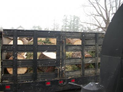

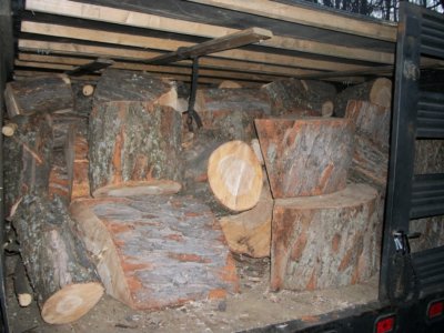

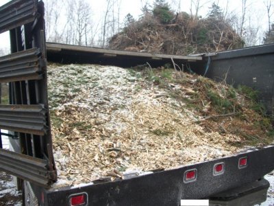

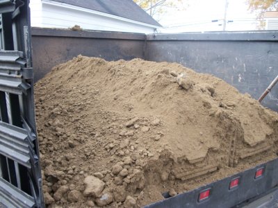

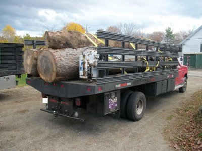

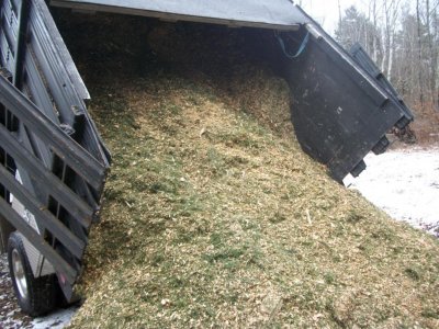

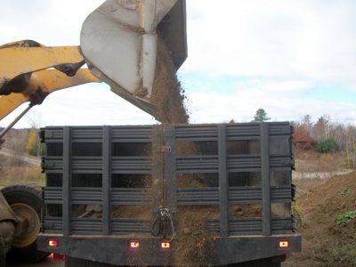

they'll take a nice jag.of course with more springs.

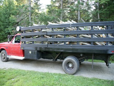

you'll like this too Jim.here's my f-super duty hauling a couple sticks.;)
