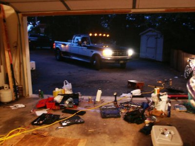

Eric & Joe are on the maiden voyage as I type this. Guess I can put the tool box back in the tool room ;Sweet

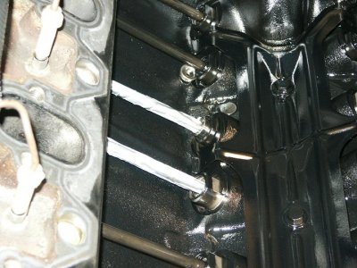

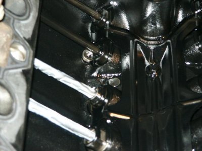

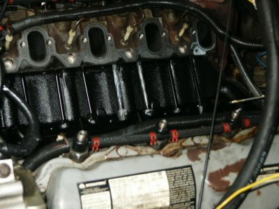

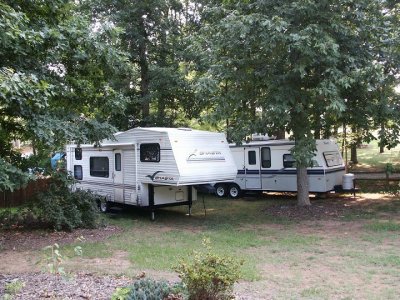

A rough idle at times. Probably trash in an injector or line. Major failure of the #5 lifter on the exhaust side. Pending failure of the intake lifter. The metal wire that retains the cap that the push rod sits in was almost gone on the intake. Cam looked good and so did all of the other lifters, push rods and rockers. As Eric mentioned, the turbo was a ***** getting off and on. (Why did it take 8 + hrs the first time it was installed? We did a R&R in less time!) Many, many thanks to all for the well wishes, phone calls, parts, and most of all to the Boutin household. BTW-Eric now has 30 amp service in the side yard for your camping pleasure! :rotflmao Here are some pics.
