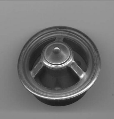

It could be you just have a bad radiator cap, should be a 13# cap. If the overtemp lite didn't come on, then it didn't overheat. Check your t'stat for the correct one, must/should be an IH or Motorcraft as shown below. Fill the radiator to within 1" of the top, fill the overflow reservoir to the marked level, keep the overflow tube at the bottom so it don't suck air into the rad when cooling off.
I would also check the water pump for leak out the drain hole on the bottom of it.
