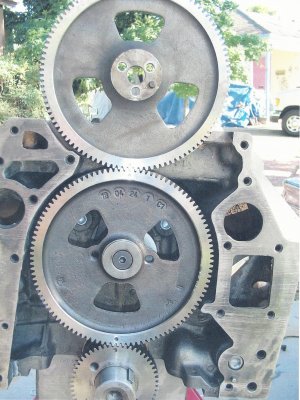

I feel its out of time also but... Pulling the gear cover to check it is a tuff job if you get it wrong... About the smoke... Is the air filter and supporting ducts clean. How old it the pump and the filter. Can you look at the injection pump gear cover and tell if its been removed before you got the truck. If you remove the gear cover don't have the injection pump connected to it. remove the pump first... Then you can easily remove the gear cover. Then use a tiny inspection mirror and reach down into the gear to see the timing marks. They should look like this....

Using the pics, take the small cover off the front of the IP housing and you might be able to tell if the dowel is in about the same position when the timing mark on the crank pulley is lined up. Worth a shot.
