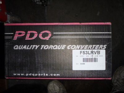

The bds is what I was going to run. Now I'm thinking about the one Towcat posted.
have yet to get down to my shop. I've been installing these convertors on service trucks for the last 10 years without any unit failure. Retail cost is roughly $200. I have one left in stock for my truck.
here's the part number.
this one might not have the torrington needle bearings by looking at the part number coding.
As always....TALK TO THE TECH REP THERE.
they build these units to order so there will be a short lag time between ordering and shipping but it's not obnoxious.
BTW......once one of these are purchased and installed, I use another shop to do rebuilds on these torque converters.
if the fins aren't destroyed, they are rebuildable. :D
