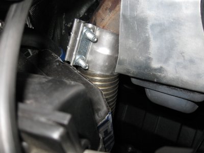

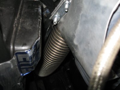

Eariler in the post someome suggested 3" Stainless Flex Pipe and SS bans clamps. That is what I did, and it works great so far. Might be an option for you that is quick easy and cheap.
Here are some not so good pics:

That does seem like a good idea.... it might end up being hte best choice, because i don't know if anyone's going to have the right downpipe for the truck anymore, except ATS, which isn't a direct bolt up AND is on backorder for 4 weeks! Those pics work good enough for me to see, thanks!!
I don't know what i'd do without ya'll!
Also, I picked up the stacks last night, they are 6" turnouts, free is free, but in sort of bad news I don't have the cross pipe for in the bed for them, so we'll see what happens with that...... I will get some pics!
If you go with a flex pipe, make sure to use the exact same type of exhaust clamps that he did, those things won't leak, and they won't harm the flex pipe. If you try to use U bolt clamps, chances are it will leak, bad, and the flex pipe will most likely tear over time.
