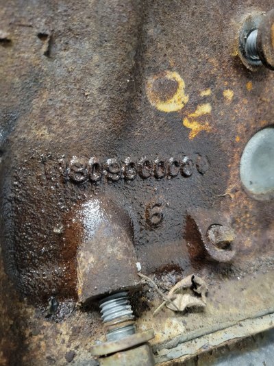

Very strange. Would not surprise me if international just used the turbo block for everything at some point even for N/A motors?

wyndnra1n
Dec 19, 2021
14
Raleigh, NC
Wow, this is an amazing resource. Thank you! From this manual, and other information found, this is 100% an N/A 7.3. However, it does have the turbo block casting number ending in C3 and the 1/4 in oil feed in the rear with an adapter down to 1/8. Navistar must have just been using the updated block for everything at that point. Once I tear into the short block I will report back with what rotating assembly is in it regarding piston pin size.
