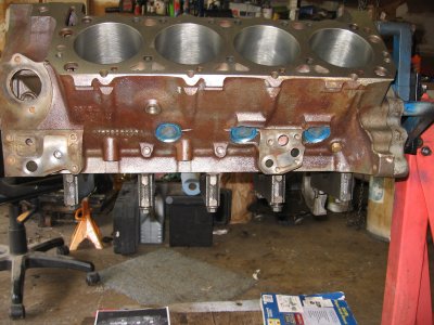

As I understand it the turbo blocks have a casting number of 10809000C3 and the non turbo blocks are 10809000C1. Can anyone confirm this with their turbo block and non turbo blocks? Thanks.... I know the 7.3 block serial numbers started at 500,079 and up to 1,116,330. Then the turbo blocks started at 1,116,331.....
1,155,105
