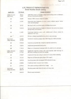

An '86 6.9 engine would be better than an '83. The earlier ones had issues with the block cracking in the area of the block heater if the block heater is used. The later blocks are a better candidate for a rebuild because the oil cooling jets are bolted in rather than pressed in.
