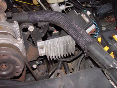

just was doing a 6.5 performance search and found your forum. I'm planning many more upgrades on my baby and this looks like a good place to get info and share my findings. so far I've had her for almost five years, bought her to tow my drag bike to the races I attend, had 28,000 when I picked her up and now she's got about 110,000 on the clock. so far I've had nothing go wrong exect PMD failures, got that fixed now with my own hand made cooler. made my own cold air kit and made my own exhaust after the flowmaster crossover and down pipe I expanded it to 3.5 inches, lost the cat and the muffler and used a tailpipe off a new duramax, yea, she's loud but not so bad all the way out the back, I plan on getting an upgraded computer and bigger injectors and a boost controller that looks better than my visegrip one!

Did you lose a PMD or just make the change to the external location/cooler because it is a good idea? The cooler looks great - did you really make it or get hold of something that was about the right size and worked?

sorry - just re-read your original memo - how many PMDs did you lose? the original location is dumb. I plan to move mine soon, more as a preemptive move - also I have to add an extrernal additional cooling line also as a preemptive move to prevent #8 cylinder cracking.

I went through about five of them! I made the cooler out of a hunk of 6061 aluminuim I had laying around, just put it on the ol bridgport and carved it out. never had a problem again.
