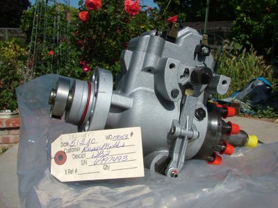

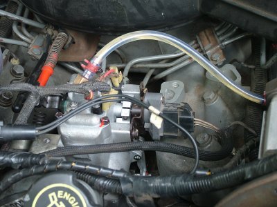

Any wrecking yard MAY have this style pump and auto trans. The C6 does not use this type of throttle drive tab. Only the E4OD needs this. I have a few of them. I had a bad one if you can imagine that. Really do not recall where it came from either. Gandalf has a nice pic of the correct orientation to the throttle shaft pic. Don't install it wrong or the tps may break or for sure it wont work.

Since Gary called me out on this, I'll post 2 pictures which seem to pertain. Maybe one of them is even the one Gary was referring to.

Thats about what these engines hold with a normal idi filter. When I use the powerstroke 1995 filters I add 2 gallons plus about 3 quarts. Yes Ken that is the best pic for showing the tps mounting to the throttle shaft correctly.
