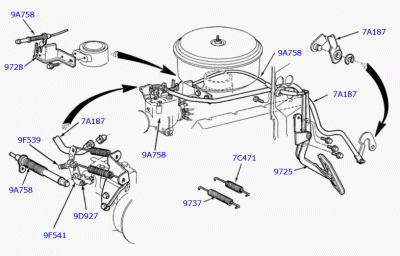

Hello I'm I'm need of help.... I installed new injection pump but after three months sitting in my garage and me sending old one month ago for rebuilt I cant remember where the c6 kick down rod hooks up I need a picture my truck is an 7.3 idi
89 model thanks Leo

I believe it was pensacola diesel my boss bought for me as I use my truck for work. Someone please show me the c6 hook up to injection pump thanks

It attaches to the throttle linkage on the IP, with an "E" clip if I'm not mistake. I'm sorry, but I don't have any photos of it.

I know it goes in the linkage my problem is that my rod don't reach and I'm afraid I'm missing something

Thank u that's what I needed I'm missing part 9f541 which Ford told me no parts r available anyone have a spare I can buy from

that part was on your old pump when you sent it in and that jerkhole at pennsicola wont tell you that or send you the part back. you were supposed to remove that before sending it.
