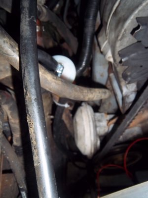

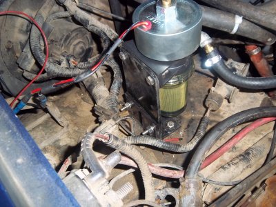

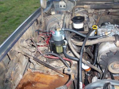

i got the pump from genlightening and today i had a some time to install it. i got everything done execpt the on and off switch. it was a loud sob priming up then it got real quiet.

once you do,you'll never look back.;Sweet
looks good jonathan.
thats where mine is,but laying down on its side just bolted to the fender.
you pre-filtered a pump with a pre-filter i see.:)

its made to pull fuel (unlike most e-pumps.)
take advantage of this and mount it up in the engine bay.
this way its easy to service and stays in the safety of the engine bay.
its also good to have mounted up here,because it has a built in check valve.meaning your fuel line will remain full despite what fuel/air leaks happen latter down the road,your pump will only have to push air/fuel out of the line in the event of a drain back to the pump it only has a short way to purge the air,and aid in a faster start when them dang leaky caps start leaking on ya.;Sweet
its also all low pressure.don't be afraid to run your own diesel rated rubber fuel line.it's easy as pie.

yeah those pre filters are rated for 20 microns so with a little luck it will help save the main filter plus you can get them any where. :D.
