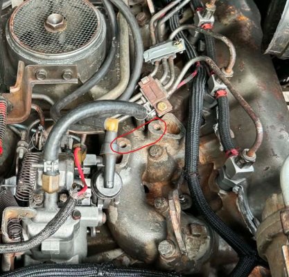

I'm trying to determine whether something is missing from my 1987 F250 6.9 IDI.
In the attached photo, I've circled two threaded holes on the driver side of the intake manifold, near the injection pump.
Can anyone identify what factory bracket, accessory, or component was originally mounted here?
Thanks in advance!

That is also where the stock 092 turbo air filter housing bolts to.

And it's also where part of the Banks Sidewinder air filter assembly bolts on.
