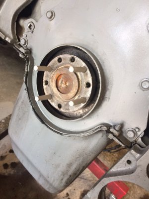

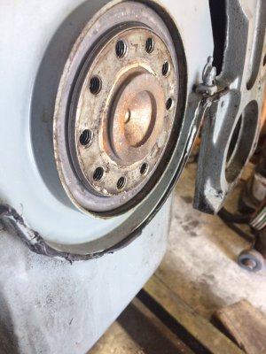

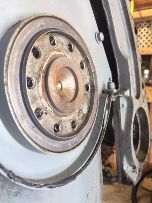

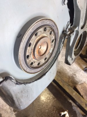

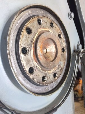

Here is a pic of my Ford/Navistar seal being installed with the speedi sleeve.
Some of the pictures are rotataed just to show it going on. The 4 plastic dowels are used to line up the installation tool. BUT, I had almost no luck with the installation tool. The plastic just reverberated back harder than it was to actually get the sleeve and seal started. I used Al/riotwarrior's "Elephant snot" or Permatex aviation form a gasket on the speedi sleeve. 800 miles so far and it's still dry.
