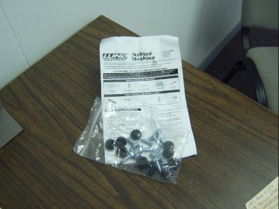

contact lund, tell them you have a moonvisor and you need the hardware kit. or just tell them you would like the instructions emailed to you. there a great CO to deal with. when you mount just remember to use some sort of sealent on the holes.
looks like the pic got posted;Sweet what you don't see is the two bolts in the center front. you start with those first. The three that you do see in the pic are done next.

Install kit is $10.00 from Lund, you get the screws, caps, lund badge, and instructions. I have boght a couple of them the last couple of months, I will be using one on my truck soon.
